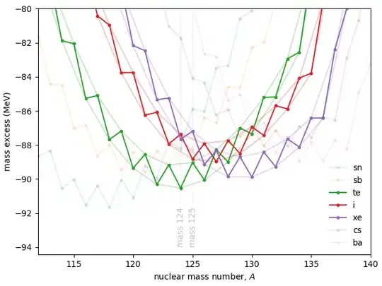

Here's a plot of the mass excesses (as defined and tabulated here) for some isotopes in this charge and mass region. Think of the mass excess as a more-useful proxy for the nuclear binding energy. To determine the $Q$-value for a beta-emission or electron-capture decay, you can just read the difference in mass excess off of this plot, in energy units. (The $Q$-value for positron emission is reduced by $2m_e c^2 = 1.022\rm\,MeV$ compared to the $Q$-value for election capture, to account for extra electron and positron in the final state.)
mass excess plot for Sb, Te, I, Xe, Cs
You can see that the binding energy (as represented by mass excess) for each element is roughly parabolic: the most stable xenon isotopes are around $A=129$, and the most stable tellurium isotopes are around $A=124$. But each element's mass-excess curve is jagged, as if there are two parabolae overlapping. That's the pairing effect. Xenon and tellurium are even-$Z$ nuclei, so the even-$A$ isotopes are more stable. But iodine is an odd-$Z$ nucleus, so the odd-$A$ (that is, $(Z,N)$ odd-even) isotopes are more stable than the odd-odd isotopes. And you can read off the plot, for example, that the only stable isotope of iodine is I-127: that's the only $A$ where the red curve has the most negative mass excess.
And if you can see that, then you can see why the xenon-125 may single-beta decay, while xenon-124 must double-beta decay. Xe-125 to I-125 is an even-odd to odd-even decay, which happens to be allowed, and doesn't have much difference in $Q$-value from the highly-suppressed double-beta decay of Xe-125 to Te-125. However, in the mass-124 system, xenon to iodine would be a decay from even-even to odd-odd, which is always suppressed due to the fact that nucleons prefer same-charge pairs to neutron-proton pairs. The fact that iodine-124 is more massive than xenon-124, which makes the decay $\rm ^{124}Xe \to{}^{124}I$ completely forbidden rather than just highly suppressed, is more or less a coincidence; but the fact than an even-even to odd-odd decay is suppressed compared to neighboring systems is clearly an effect of the nucleon-nucleon pairing interaction.

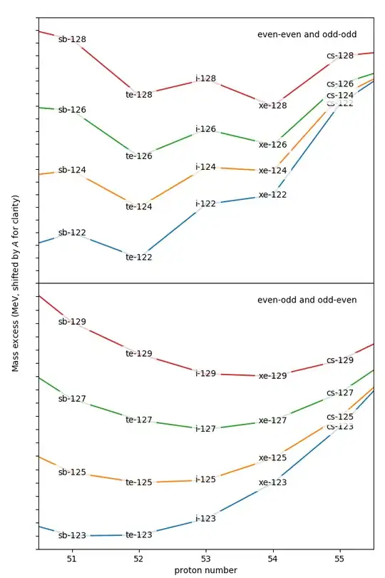

Here's another view into the same data set. But rather than grouping the isotopes by their proton number and showing all the mass data on the same scale, here the isotopes are grouped by their mass number. Weak decays will move a nucleus along the solid colored lines towards the minimum of each mass-excess curve. Decays to the left are electron capture and positron emission; decays to the right are $\beta^-$ emission.
mass excesses, grouped by mass number
Emilio's answer is basically a text description of the orange curve in the top half of the plot, where the even-$A$ isobars live. Your question is why the orange curves in the two plots (mass 124 and mass 125) are different from each other. And the answer is, again, the nucleon pairing interaction. Turning an even-even nucleus into an odd-odd nucleus is expensive in a way that turning an even-odd to an odd-even nucleus is not.
Note from this second plot that $\rm^{126}Xe \to{}^{126}Te$ is also a candidate for double-electron capture, though the lifetime will be longer than the observed $2\epsilon$ decay in the mass-124 system because the $Q$-value isn't as large. In the mass-128 system, the possible double-weak decay is the other way, from tellurium to xenon.

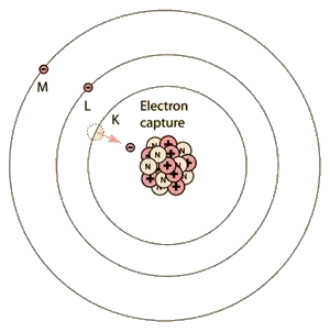

electcap
This is a schematic that grossly distorts the picture relative to a scale model of the atom. The electron orbit radii are tens of thousands of times the diameter of the nucleus. ....
The capture of the electron by a proton in the nucleus is accompanied by the emission of a neutrino. The process leaves a vacancy in the electron energy level from which the electron came, and that vacancy is either filled by the dropping down of a higher-level electron with the emission of an X-ray or by the ejection of an outer electron in a process called the Auger effect.
As the quote states the distances in the image are deceptive. As far as the K shell (principal quantum number-energy level) of the closest electron is concerned, the nucleus is a point. For electron capture to happen there should be a probability for the electron to exist in the angular momentum zero state, the S state which overlaps with the nucleus.
Thus your question reduces to : why two electrons from the K shell have a higher probability to overlap with the Xenon nucleus than one electron ? since you state that the one electron capture is unmeasurable. That is what I mean for a specific mathematical model. People are working on this as you can see here.
The existing decay mode for Xe125 and not for Xe124 again would need a specific shell model calculation to be fitted, though with an extra neutron one expects less stability of the nucleus.
To get a feeling see here the electron orbitals of hydrogen where the central point would be the nucleus overlapped with the electron, fortunately the proton has a smaller mass than the neutron, so even if a small geometrical probability of overlap exists, the probability is zero for the decay due to energy conservation.
