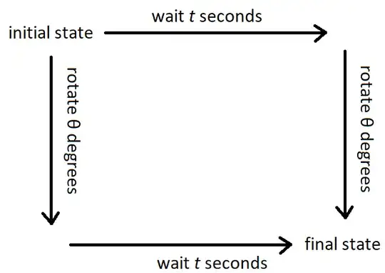

The time evolution operator is given by exponentiating the Hamiltonian: $$ U(t) = \exp(-i t\hat H / \hbar ). $$ For concreteness, when we think about a symmetry operation (what you called $U$) let's think about rotations around the $z$-axis. A rotation by $\theta$ degrees is given by $$ R(\theta) = \exp(-i\theta \hat J_z/\hbar) $$ where $\hat J_z$ is the angular momentum operator in the $z$-direction.
If our symmetry commutes with time translations, we have
$$ [U(t), R(\theta)] = 0 \implies U(t) R(\theta) = R(\theta) U(t). $$
This means that, for any $|\psi \rangle$,
$$ U(t) R(\theta) |\psi \rangle = R(\theta) U(t) |\psi \rangle. $$
In other words, if you rotate the state by $\theta$ degrees and then wait $t$ seconds, you will end up with the same state as if you first waited $t$ seconds before rotating $\theta$ degrees.
The "commutativity" of these operations is often what physicists mean when they say they have a symmetry.
By differentiating the equation $[U(t), R(\theta)] = 0$ by $t$, $\theta$, or both, we can see that this statement is actually equivalent to four closely related statements
  1. $[e^{-i t \hat H/\hbar}, e^{- i \theta \hat J/\hbar}] = 0$: Rotating and then time evolving a state is the same as time evolving and then rotating. (We have a symmetry.)
  2. $[e^{-i t \hat H/\hbar},\hat J] = 0$: The angular momentum of a state does not change after time evolution. (Angular momentum is conserved.)
  3. $[\hat H, e^{- i \theta \hat J/\hbar}] = 0$: The energy of a state does not change if the state is rotated.
  4. $[\hat H, \hat J] = 0$: If you measure the angular momentum of a state, the probability that the state will have any particular energy afterwards will not change. The reverse is also true. ($\hat H$ and $\hat J$ can be simultaneously diagonalized.)
