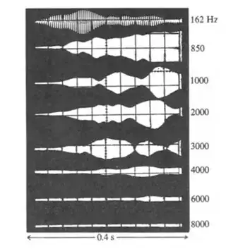

When the gong is struck, most of the energy goes into low frequencies, and nonlinear effects feed it into higher frequencies only gradually. For example, Fletcher and Rossing (1982) collect the following data for the buildup and decay of vibrations in different frequency bands:
Quoting The Physics of Musical Instruments again:
The initial large excitation of low-frequency modes is apparent, as is the subsequent transfer of vibrational energy to modes in the range 1- 5 kHz, which contribute the late-developing "sheen" to the sound.
Fletcher and Rossing don't mention "warming up" the gong at all, but presumably the point of this is to get some energy into the higher-frequency modes from the beginning, so that they can build up quicker, giving a brighter and more immediate sound. (Of course, this "warming up" has nothing to do with the temperature of the gong.)
