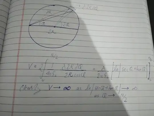

I calculated the electric potential at any point (assuming zero potential at infinity) on the circumference of a uniformly charged ring (non conducting) and after evaluating that integral it turns out to be infinite!

EDIT:I can show how I evaluated the potential at circumference of ringenter image description here
