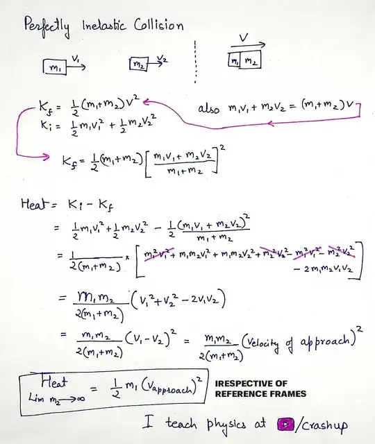

enter image description hereI think I have the answer. The change in kinetic energy of the ball after impact in the moving elevator is more. But it is wrong to assume that all of it will be converted into heat. a part of it may be transferred and added to the KE of the elevator. Now what was the KE of the elevator? As we assumed it to be very heavy as compared to the falling object, elevator's mass was infinite. So with any finite velocity, it's KE becomes infinite. We will never get to know how much of falling objects KE got transferred to the moving elevator as it's KE was infinite before and after the impact. In order to find the amount of KE converted into heat, we must get into a reference frame where KE of the elevator is not infinite. and with infinite mass, only if the velocity of the elevator is zero, we will get a finite (zero) KE of the elevator. that's why we must calculate the KE lost in a frame of reference where the elevator is at rest.
We've been doing this all the time. if the elevator is at rest, it's sitting on the Earth, which is a huge ball with infinite mass. so we calculate the KE lost of small falling object from a reference frame in which the Earth is at rest. consider a frame of reference in which the earth is moving at 5m/s and hits a ball at rest (perfectly inelastic). change in KE of the earth will be zero (before and after the impact, KE is infinite), but the KE of ball will increase to some finite value. and it'll also get some heat. where did that energy come from?
