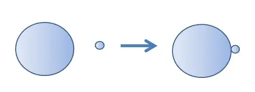

Yes, many things rob Earth's angular momentum and slow it down. For example, when a rocket lands on Earth, it gains/loses speed due to the Earth's rotation. Other than that, when a rocket leaves Earth, they use the fact that the Earth rotates in order to gain kinetic energy from the Earth's rotation. In other words, the rocket robs the Earth's energy.
NASA uses this fact to their advantage. Their 'rob' Earth's energy to speed up their spacecraft during launch.
This relates to angular momentum because the rocket acts as a mass being added or removed from the side of a spinning 'sphere' (the Earth). If you use calculations, you would find things like conservation of energy and conservation of angular momentum.

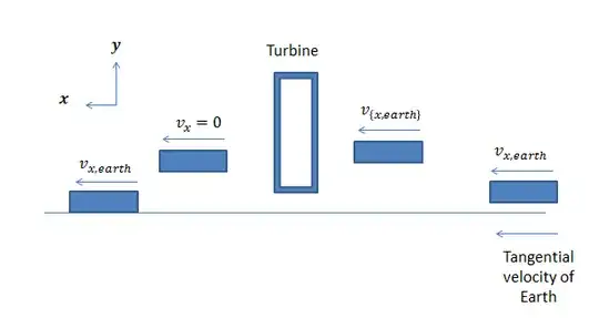

Edit: Let's imagine that Earth's atmosphere doesn't exist. So we have a big rotating sphere in vacuum we could launch a spacecraft in the direction of rotation, have some turbines 'take' the spacecraft's kinetic energy, let the spacecraft land, and repeat. It's a simplified version of some system. We could even use magnets and Faraday's law (the spacecraft is a magnet) instead of some turbine.
$\Delta L = mv_{initial} r - (\Sigma m)v_{final} r $
$= m_{earth} r_{earth} v_{earth,initial} - {v_{earth,final} (m_{earth} r_{earth} + m_{rocket} r_{rocket})}$
Since $v_{initial} \approx v_{final}$, we have $\Delta L = -vrm_{rocket}$
