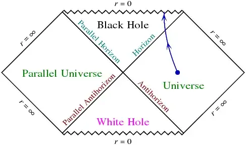

The Penrose diagram for a non-spinning Schwarzschild black hole is enter image description here
Notably, there is a second universe "on the other side" of the black hole. However, actual black holes form by stellar collapse, and the collapse process leads to a different Penrose diagram:

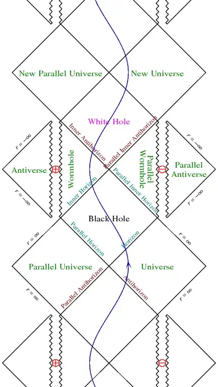

A spinning Kerr black hole famously has the following crazy Penrose diagram:
The Kerr spacetime has two horizons, in natural units $r_\pm= M \pm \sqrt{M^2 - a^2}$ where the angular momentum is $J = aM$. $r_+$ is the regular event horizon. Inside of that is $r_-$, where you can begin navigating to leave the black hole and enter an entirely new universe. (You can also pass through the ring singularity, or the "ringularity", and enter an "antiverse.")
My question is, what is the Penrose diagram for a realistic black hole that forms via stellar collapse, and not an idealized "eternal" Kerr black hole? What happens to the parallel universes, $r_-$, and the antiverses? Do any of these features remain?

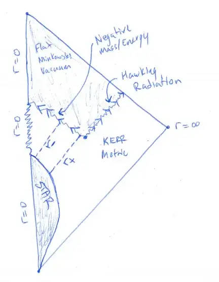

Here is one toy-model possibility, assuming that the BH forms from a collapsing star, then evaporates by emitting an outgoing burst of Hawking radiation from just outside the trapping horizon, while absorbing a burst of negative mass. An evaporation model with ingoing/outgoing fluxes of negative/positive energy like this is motivated by the DFU stress tensor for Hawking radiation.
If this was for a charged nonrotating BH, which has a similar causal structure, this would be pretty satisfying. Then we could say:
  • The collapsing star surface cuts off unwanted past regions.
  • The evaporation process cuts off unwanted future regions.
Unfortunately, for the rotating BH, this only represents the $\theta=0$ axis, so there are problems:
  • Not clear what other $\theta$ values look like in diagram.
  • By going to other $\theta$ values, you can still go through the ring singularity and get to unwanted regions.
