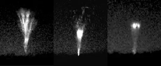

They exist, they're just rarer, which is why you don't often see them. They're called gigantic jets, and they connect storm clouds to the reservoir of charge in the ionosphere. Here's one that was photographed during Tropical Storm Cristobal in 2008 (source: https://www.livescience.com/10572-gigantic-lightning-jets-shoot-clouds-space.html): enter image description here
Unfortunately, not very much is known about the conditions under which they form, so there's not really a good explanation why they're so rare at the moment.
