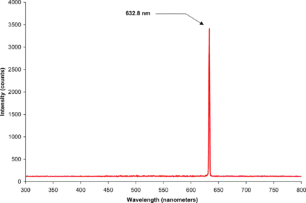

@ErickShock's answer is perfectly correct, but let's look at some numbers. A HeNe laser spectrum shown:
with a peak at
$$\nu = c/\lambda = 473755.4646016\,{\rm GHz}$$
If we send out a $\tau = 1$ millisecond pulse, we can call that monochromatic pulse that 182 miles long--physically it is a very long pulse. It is not infinite (per the OP's complaint), but it is much larger than the lab.
Mathematically, we model it with:
$$ \sin{(2\pi\nu t)} \times {\rm rect(0,\tau)} $$
The Fourier spectrum of that then has a width of:
$$\Delta\nu \approx 1/\tau = 1\, {\rm kHz}$$.
So the modeled pulse has a frequency range:
$$ \nu = 473755.4646016 \pm 0.000001\,{\rm GHz}$$
(and hence a coherence length of 182 miles).
Meanwhile, an actual HeNe laser has a bandwidth on the order of 1.5 GHz ( 1 foot coherence length).
So, the deviations from "truly monochromatic" (in space or time) caused by the finite size of the apparatus or duration of operation are tiny compared with the inherent deviations in the device itself.
