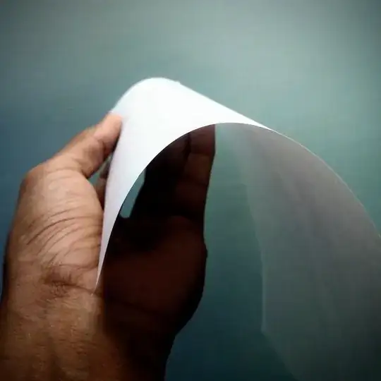

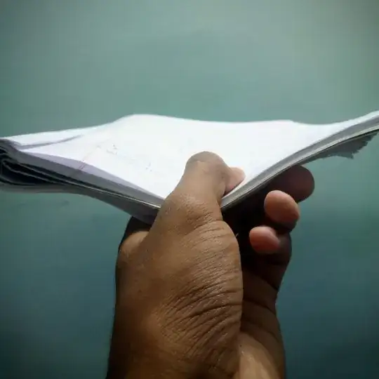

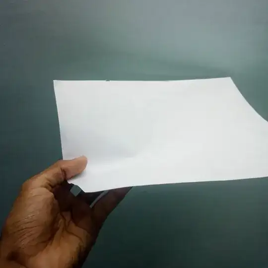

I noticed that I have been bending my book all along, when I was reading it with one hand.
book
This also works for plane flexible sheets of any material.
Illustration using an A4 sheet
Without bending the sheet: No bend
With a bend along perpendicular axis With bend
How do you explain this sturdiness, that comes only when the object is bent along the perpendicular axis ? I feel that this is a problem related to the elastic properties of thin planes. But any other versions are also welcome.

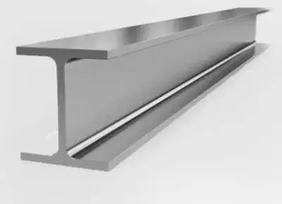

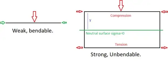

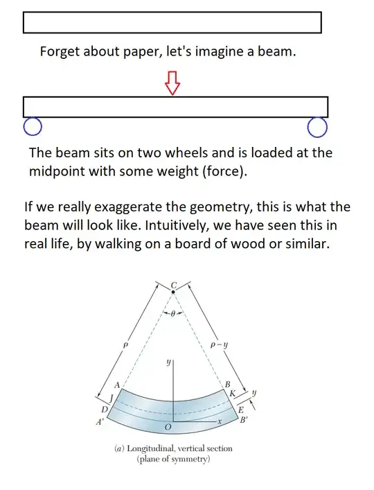

You have essentially discovered principles behind bending moments and structural engineering.
As another poster stated, physically the structure you made is stronger, because to bend something (for example, a beam loaded at the top) layers at the top are compressed whereas layers at the bottom are stretched. This is simply due to geometry and the physical nature of materials. In short, the load (force) is being transformed from a direction normal to the beam, to an internal force—longitudinal stress. More specifically, the applied load (from weight, gravity, whatever) results in a bending moment in the member, this bending moment manifests as internal stresses (tensile and compressive forces) inside the member that resists the bending of equal magnitude.
Some primers on forces: compression and tension are the same thing, just different "directions" ie: if compression is -1 or -2, then tension will be 1 or 2. Knowing that, and knowing that the top of the member is in compression and the bottom is in tension, we can reason that there is a force distribution across the member. And I think the most important part to your question is that since the force distribution goes from -x to +x across the member, there must be some point where x = 0 (the neutral surface). In the picture below the stress (green arrows) at some point cross 0.
Therefore, we can observe that maximum stresses occur at the edges, top and bottom of the beam in our example. This principle is precisely how and why I-beams work. The strength of the member comes from the material properties of the material (its ability to resist compression or tension (stretching)). That means something like a steel beam will be limited in its ability to resist bending by the calculation of tensile load at the surface. Physically that equation is (for the $x$ direction):
$\sigma_{x}=-\frac{y}{c}\sigma_{m}$
Where $c$ is the neutral surface (the imaginary plane where $\sigma_{x}=0$) and $y$ is the distance from the neutral surface, and $\sigma_{m}$ is the maximum absolute value of the stress in the member.
In layman's terms, the height of the beam is the driving factor in it's strength, not the thickness. But in the plane that is experiencing maximum loads (tension and compression) thickness there will give you more strength. This results in the classic I-beam shape.
What does all of this have to do with paper?
When the OP orients the paper horizontally (flat), the height of the paper relative to the neutral surface is basically 0. IE we can consider that the entire paper IS a neutral surface. That means it literally cannot resist any bending. Flip the paper 90 degrees and now all of the paper is height, and all of the paper can resist bending and it cannot be bent. It will usually buckle or tear before bending.
The curved shape OP creates, is exploiting the all the concepts we covered here. Instead of making an I shape, OP makes a C-shape which leads to the idea of exploiting thin materials by using corrugation to add incredible strength while keeping weight low. For example, the inside layers of a cardboard box are corrugated or folded into little curved shapes to resist bending. So we can use less material to achieve much higher strengths.

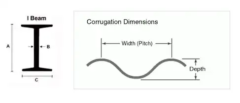

"Curving" the paper increases the second moment of area, beacuse it effectively increases the distance of the paper cross-sectional area from the section centroid.
Stiffness of a cross-section is proportional to the square of distance from the centroid (also see parallel axis theorem), so curving the paper effectively multiplies it's stiffness by several orders of magnitude, thus the curved paper exhibits minimal displacement (= remains straight).
Here's another example of the same principle. A paper held horizontally bends under it's own weight. A perfectly flat paper held perfectly vertically is perfectly capable to carry it's own weight with minimal displacement. It is the same principle, radical increase in stiffness along the bending direction through increase of distance from the centroid.

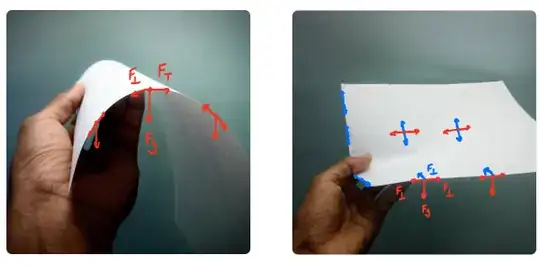

I'm going to try another intuitive answer, since we seem to have quite a few technical answers here. As you say, it's all about the elastic properties.
When you hold the paper without a crease, you are giving a boundary condition to the surface - horizontal, in this case. Each point on the rest of the paper feels a downwards force of gravity, as well as parallel contact (electrostatic) forces to the surface. However, these forces are entirely in the direction of the curve, because the boundary condition you've set does not include any components along the translation direction of the cylinder (see the figure).
However, when you do induce those components, by changing the boundary conditions, you create forces in all (parallel to the surface) directions at every point. These forces are essentially there because the paper cannot be discontinuously changed (that's part of the elastic properties you mentioned). If the paper is long enough, the gravitational force may eventually win and the paper might fall (or rip, or crease).
