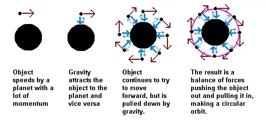

Let's take earth and sun for example. From this picture I understand that earth is being pulled by sun constantly but I don't understand where the opposing force is coming from. How can earth still keep opposing sun's gravity for millions of years. Where is the force coming from? Shouldn't earth be slowing down and eventually collapse into sun? If no then does that mean that there the opposing force is being constantly applied. Or the earth had some initial momentum and it never loses that momentum for some reason? But that doesn't seem intuitive, because if you throw something on earth it falls down because gravity is stronger than that momentum. But in space if earth is being constantly pulled by sun and earth is opposing that pull constantly, shouldn't earth need to use energy to oppose the pull and eventually lose all of it's momentum? I've heard about the theory that earth is actually constantly falling into sun. But I can't understand that one, because I don't see why is earth evolving around sun in that theory, it seems like it should just follow sun in a straight line if it's constantly falling into it. If it's evolving then why doesn't sun crash into earth when earth is in front of it? To sum it up here are my questions:

If the earth is constantly falling into sun, how can it also evolve around it? Shouldn't it go in a straight line after sun?
I guess you mean revolve, not evolve. The rotation of the Earth around the sun is a balance of two forces, one force pulling it towards the Sun, the other force keeping it moving in a straight line. This is illustrated in the article: Circular Rotation, although as noted in the comments, the planets move in elliptical paths rather than circular orbits.
