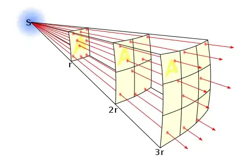

You can see that it has to be an inverse square law by symmetry. The other arguments for this question involve gravitons, but the argument works just as well even for fields. Conservation of flux
From the image a general idea of the argument can be seen. The argument goes like so:
If you consider a point mass in space, and then claim that it has a "gravitational field" around it, then from the law of conservation of energy the energy of the field has to be conserved in all space. But since the source of the field is a point mass, it is also clear that the field has to be spherically symmetric (since from every region around the point mass, the point mass looks the same). So if we consider a spherical region around the point and measure the total field passing through that surface (called the flux of the field) and then consider another spherical region with a larger radius and measure the field passing through that surface, the total field through both spherical surfaces must be equal.
But the surface area of the sphere goes up as $4\pi r^2$. Therefore for the flux through both spherical surfaces to be the same, the field has to go down as $1/r^2$.
