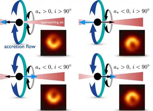

The pictures below from the fifth event horizon telescope paper makes things clear.
Relative orientation of spin and accretion flow
The black arrow indicates the direction of black hole spin. The blue arrow indicates the initial rotation of the accretion flow. The jet of M87 is more or less East-West (when projected onto the page - in fact I believe the projected jet axis position angle should be more like 72 degrees rather than 90 degrees), but the right hand side is pointing towards the Earth, with an angle of about 17 degrees between the jet and the line of sight. It is assumed that the spin vector of the black hole is aligned (or anti-aligned) with this.
The two left hand plots show agreement with the observations. What they have in common is that the black hole spin vector has a component into the page (anti-aligned with the jet), so that its projected spin vector is to the left. Gas is forced to rotate in the same way and results in projected relativistic motion towards us south of the black hole and away from us north of the black hole. Doppler boosting and beaming does the rest.
As the paper says: "the location of the peak flux in the ring is controlled by the black hole spin: it always lies roughly 90 degrees counterclockwise from the projection of the spin vector on the sky."

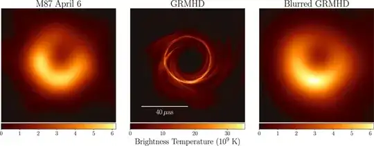

This is because of the tilt of the accretion disk with respect of our line of sight. The accretion disk is "in front" of the black hole in the southern part of the image.
You can compare with this image from the 5th paper of the ApJ Letters "First M87 Event Horizon Telescope Results. V. Physical Origin of the Asymmetric Ring", which shows one of the best-fit theoretical simulations alongside the observed image:
There is a number of other effects at play, though. You see only a narrow frequency band, so once the light is shifted by the Doppler effect to a different wavelength in either direction, or when the plasma has the wrong temperature, you stop seeing it in the image. An additional general-relativistic effect is a "space-time push" the rotation of the black hole gives to co-rotating photons, which causes a slight west-east asymmetry in the image as well.

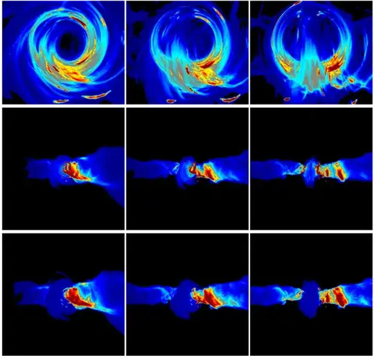

Now let me expand on Rob Jeffries answer to contribute to the picture of how the image emerges. I extracted and rotated this picture from simulations of Monika Mościbodzka and other EHT collaborators (2014, A&A):enter image description here In this picture you see simulation results where the jet as well as the black hole spin are tilted in various ways with respect to the observer (the jet and spin are always aligned here). The tilt is the same in every column, and every row represents a different magnification and wavelength of observations. You see that when the plasma is moving toward you, it appears brighter. This is relativistic Doppler beaming. There are various components to the image, including not only the disk but also the jet.
If the disk was edge on, you would see a ring created by the jet (plus disk-to-jet transitioning matter) that is stricken through by the main disk. This corresponds to the right-most column. As you rotate more and more (but not quite) face-on towards the disk, there will still be a component of the plasma that ends up being strongly beamed towards you while the whole image starts looking quite a lot like a pure ring (left-most column). This is the current leading scenario for what EHT saw in M87.
