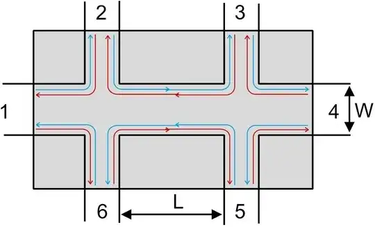

You can observe the counter propagation of the spin up (say red) and spin down (blue) along the top and bottom edges. The quantity $T_{ij}$ represents the transmission probability for the electron to go from contact $i \rightarrow j$. As you can observe from the figure only $T_{i,i+1}$ and $T_{i+1,i}$ will be nonzero. As the theory for the quantum spin Hall effect predicts that the edge states are robust to (non-magnetic) disorder, we must have $$T_{i,i+1}=T_{i+1,i}=1$$ i.e. perfect (dissipationless) transmission. Plugging this into the Landauer-Büttiker formula (and assuming a current passing from contact $1 \rightarrow 4$) above you'll get six linear equations in six unknowns ${\mu_i}$: $$\frac{e}{h}\underbrace{\left(\begin{array}{cccccc} -2 & 1 & 0 & 0 & 0 & 1\\ 1 & -2 & 1 & 0 & 0 & 0\\ 0 & 1 & -2 & 1 & 0 & 0\\ 0 & 0 & 1 & -2 & 1 & 0\\ 0 & 0 & 1 & 1 & -2 & 1\\ 1 & 0 & 0 & 0 & 1 & -2 \end{array}\right)}_{A} \underbrace{\left(\begin{array}{c} \mu_{1}\\ \mu_{2}\\ \mu_{3}\\ \mu_{4}\\ \mu_{5}\\ \mu_{6} \end{array}\right)}_{x} = I_{14}\underbrace{\left(\begin{array}{c} 1\\ 0\\ 0\\ -1\\ 0\\ 0 \end{array}\right)}_{b}.$$
However, there is a redundancy in this system of equations (or $\det\left(A\right)=0$). Not all the $\mu_i$'s are really unknowns. We can set $\mu_4 = 0$ (i.e. reference potential or ground). In that case you can reduce the system of equations to $$\frac{e}{h}\left(\begin{array}{ccccc} -2 & 1 & 0 & 0 & 1\\ 1 & -2 & 1 & 0 & 0\\ 0 & 1 & -2 & 0 & 0\\ 0 & 0 & 1 & 1 & 0\\ 1 & 0 & 0 & 1 & -2 \end{array}\right)\left(\begin{array}{c} \mu_{1}\\ \mu_{2}\\ \mu_{3}\\ \mu_{5}\\ \mu_{6} \end{array}\right)=I_{14}\left(\begin{array}{c} 1\\ 0\\ 0\\ -1\\ 0 \end{array}\right).$$ Now, solving this you get $$\left(\begin{array}{c} \mu_{1}\\ \mu_{2}\\ \mu_{3}\\ \mu_{5}\\ \mu_{6} \end{array}\right)=\frac{I_{14}h}{e}\left(\begin{array}{ccccc} -2 & 1 & 0 & 0 & 1\\ 1 & -2 & 1 & 0 & 0\\ 0 & 1 & -2 & 0 & 0\\ 0 & 0 & 1 & 1 & 0\\ 1 & 0 & 0 & 1 & -2 \end{array}\right)^{-1}\left(\begin{array}{c} 1\\ 0\\ 0\\ -1\\ 0 \end{array}\right),$$ $$\left(\begin{array}{c} \mu_{1}\\ \mu_{2}\\ \mu_{3}\\ \mu_{5}\\ \mu_{6} \end{array}\right)=\frac{I_{14}h}{e}\left(\begin{array}{c} -3/2\\ -1\\ -1/2\\ -1/2\\ -1 \end{array}\right).$$ Voltage difference across contacts $i$ and $j$ is $$V_{ij}=\frac{1}{\left(-e\right)}\left(\mu_{i}-\mu_{j}\right).$$ You can check that $$V_{14}=\left(\frac{3h}{2e^{2}}\right)I_{14}$$ and $$V_{23}=\left(\frac{h}{2e^{2}}\right)I_{14}.$$

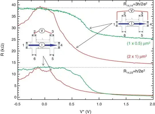

This is exactly what Roth et. al experimentally observed
These values of two- and four-terminal resistance were confirmed to be independent of the sample geometry ($L$ and $W$). As a result, you can rule out any type of conduction other than the edge states. Additionally, you expect these values of resistance only if you assume helical and dissipationless edge states. Therefore these measurements should confirm the existence of the quantum spin Hall state in HgTe.

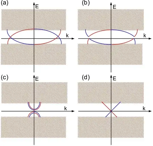

Also: Why is there only a single helical edge state per edge? Why must we have at least one and why can't we have, let's say, two states per edge?
If you had (say) two pairs of counter propagating helical edge states then such a system is not robust to disorder. Such a situation is shown in part (a) (in the absence of disorder) in the figure below. The states belonging to the red and blue bands at the same height (i.e. same energy $E(\mathbf{k},\uparrow)=E(-\mathbf{k},\downarrow)$) form Kramers' partners. The brown shaded regions represent the bulk bands. Since you have two pairs of Kramers' partners, the respective bands will naturally intersect at two points (as shown in part (a)). Any kind of disorder will result in gapping out of the states as shown in part (b). But note that such a gapping out process is permitted by Kramers' theorem. A quick way to see this is: look at the reflection of any band with respect to the vertical ($k=0$) axis. Under such reflections red should transform into blue and vice versa.
Now, imagine that you had two copies of Dirac-like helical edge states. In other words, two copies of part (d) superimposed on one another. When you gap out the system it will look like part (c). You can observe that in the part (c) time reversal symmetry is still preserved after gapping. In part (d), however, you only have one copy of Kramers' partners. There is only one point of intersection (as opposed to parts (a) and (b)). You can observe that there is no way in which you can open a gap (at $k=0$) while still satisfying time reversal symmetry. More specifically, introducing a gap (in part (d)) will only violate Kramers theorem at the $k=0$ point (i.e. $E(\mathbf{k},\uparrow)$ and $E(-\mathbf{k},\downarrow)$ will not be equal at $k=0$). Hence if the disorder respects time reversal symmetry then such a band intersection is said to be "protected by time reversal symmetry." In realistic systems like the HgTe quantum well, say you had $2n+1$ Kramers' partners. In that case disorder will destroy such Kramers' partners in $n$ pairs such that only one pair is left in the end. The existence of odd number of pairs is guaranteed in a topologically nontrivial phase. In fact, that is how people identify a topologically nontrivial phase.
