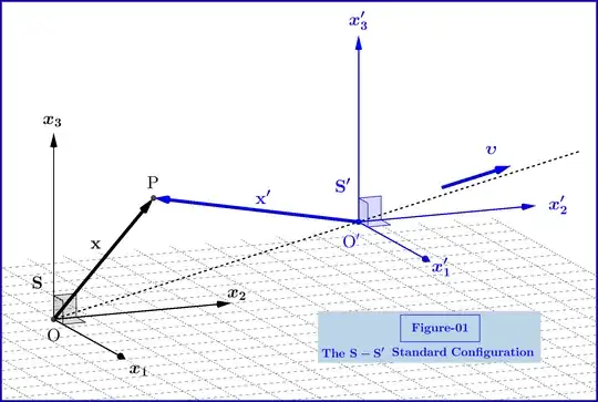

In above Figure-01 an inertial system $\:\mathrm S'\:$ is translated with respect to the inertial system $\:\mathrm S\:$ with constant velocity
\begin{align} \boldsymbol{\upsilon} & \boldsymbol{=}\left(\upsilon_{1},\upsilon_{2},\upsilon_{3}\right) \tag{02a}\label{02a}\\ \upsilon & \boldsymbol{=}\Vert \boldsymbol{\upsilon} \Vert \boldsymbol{=} \sqrt{ \upsilon^2_{1}\boldsymbol{+}\upsilon^2_{2}\boldsymbol{+}\upsilon^2_{3}}\:\in \left(0,c\right) \tag{02b}\label{02b} \end{align}
The Lorentz transformation is \begin{align} \mathbf{x}^{\boldsymbol{\prime}} & \boldsymbol{=} \mathbf{x}\boldsymbol{+} \dfrac{\gamma^2}{c^2 \left(\gamma\boldsymbol{+}1\right)}\left(\boldsymbol{\upsilon}\boldsymbol{\cdot} \mathbf{x}\right)\boldsymbol{\upsilon}\boldsymbol{-}\dfrac{\gamma\boldsymbol{\upsilon}}{c}c\,t \tag{03a}\label{03a}\\ c\,t^{\boldsymbol{\prime}} & \boldsymbol{=} \gamma\left(c\,t\boldsymbol{-} \dfrac{\boldsymbol{\upsilon}\boldsymbol{\cdot} \mathbf{x}}{c}\right) \tag{03b}\label{03b}\\ \gamma & \boldsymbol{=} \left(1\boldsymbol{-}\dfrac{\upsilon^2}{c^2}\right)^{\boldsymbol{-}\frac12} \tag{03c}\label{03c} \end{align}

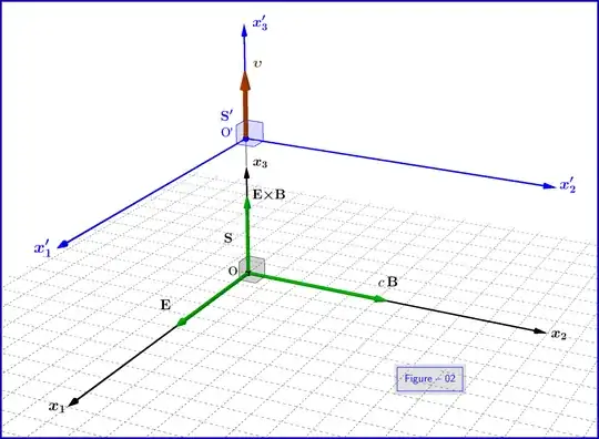

Now, consider a point in space where $\:\mathbf{E}\:$ and $\:\mathbf{B}\:$ are perpendicular, that is $\:\mathbf{E}\boldsymbol{\cdot}\mathbf{B}\boldsymbol{=}0$ as in Figure-02. Let a system $\:\mathrm S'\:$ moving along the common $\:x_{3}-x'_{3}\:$ axis with constant velocity \begin{equation} \boldsymbol{\upsilon}\boldsymbol{=}\upsilon \,\dfrac{\mathbf E\boldsymbol{\times}\mathbf B}{\Vert\mathbf E\boldsymbol{\times}\mathbf B\Vert}\boldsymbol{=}\upsilon \,\dfrac{\mathbf E\boldsymbol{\times}\mathbf B}{E\,B} \tag{05}\label{05} \end{equation} We insert this expression of $\:\boldsymbol{\upsilon}\:$ in equations \eqref{04a},\eqref{04b} to have \begin{align} \mathbf{E}' & \boldsymbol{=}\gamma \left[\mathbf{E}\,\boldsymbol{+}\:\boldsymbol{\upsilon}\boldsymbol{\times}\mathbf{B}\vphantom{\dfrac{\boldsymbol{\upsilon}}{c^2}}\right]\boldsymbol{=}\gamma \left[1\boldsymbol{-}\dfrac{\upsilon}{c}\left(\dfrac{c B}{E}\right)\right]\mathbf{E} \tag{06a}\label{06a}\\ \mathbf{B}' & \boldsymbol{=}\gamma \left[\mathbf{B}\boldsymbol{-}\dfrac{\boldsymbol{\upsilon}}{c^2}\boldsymbol{\times}\mathbf{E}\right]\boldsymbol{=}\gamma \left[1\boldsymbol{-}\dfrac{\upsilon}{c}\left(\dfrac{E}{cB}\right)\right]\mathbf{B} \tag{06b}\label{06b} \end{align} For the path from expressions \eqref{04a},\eqref{04b} to expressions \eqref{06a},\eqref{06b} on the one hand we use the fact that \begin{equation} \left(\mathbf{E}\boldsymbol{\cdot}\boldsymbol{\upsilon}\right)\boldsymbol{=}0\boldsymbol{=}\left(\mathbf{B}\boldsymbol{\cdot}\boldsymbol{\upsilon}\right) \tag{07}\label{07} \end{equation} and on the other hand using the vector identity \begin{equation} \left(\mathbf a\boldsymbol{\times}\mathbf b\right)\boldsymbol{\times}\mathbf c \boldsymbol{=}\left(\mathbf a\boldsymbol{\cdot}\mathbf c\right)\mathbf b\boldsymbol{-}\left(\mathbf b\boldsymbol{\cdot}\mathbf c\right)\mathbf a \tag{08}\label{08} \end{equation} we have \begin{align} \require{cancel} \left(\mathbf E\boldsymbol{\times}\mathbf B\right)\boldsymbol{\times}\mathbf B & \boldsymbol{=}\left(\mathbf E\boldsymbol{\cdot}\mathbf B\right)\mathbf B\boldsymbol{-}\left(\mathbf B\boldsymbol{\cdot}\mathbf B\right)\mathbf E\boldsymbol{=}\cancelto{0}{\left(\mathbf E\boldsymbol{\cdot}\mathbf B\right)}\mathbf B\boldsymbol{-}B^2\mathbf E\boldsymbol{=}\boldsymbol{-}B^2\mathbf E \tag{09a}\label{09a}\\ \left(\mathbf E\boldsymbol{\times}\mathbf B\right)\boldsymbol{\times}\mathbf E & \boldsymbol{=}\left(\mathbf E\boldsymbol{\cdot}\mathbf E\right)\mathbf B\,\boldsymbol{-}\left(\mathbf B\boldsymbol{\cdot}\mathbf E\right)\mathbf E\boldsymbol{=}E^2 \mathbf B\boldsymbol{-}\cancelto{0}{\left(\mathbf E\boldsymbol{\cdot}\mathbf B\right)}\mathbf E\boldsymbol{=}\boldsymbol{+}E^2 \mathbf B \tag{09b}\label{09b} \end{align}
Now, depending on the sign of the Invariant 1 we have :
  1. If $\quad\boxed{\:E^2\boldsymbol{-}c^2B^2 >0\:\vphantom{\dfrac{a}{b}}}\quad$ then in the system $\:\mathrm S'\:$ of Figure-02, the last moving with speed \begin{equation} \upsilon_{\bf es}\boldsymbol{=}\left(\dfrac{cB}{E}\right)c<c \tag{10}\label{10} \end{equation} there exists non-zero electric field but not magnetic field. We call this case electrostatic and we use the subscript $\:\bf es\:$, for the system the symbol $\:\mathrm S_{\bf es}\:$ and for the electromagnetic vectors \begin{equation} \mathbf E_{\bf es}\boldsymbol{=}\left(1\boldsymbol{-}\dfrac{c^2 B^2}{E^2}\right)^{\!\!\boldsymbol{\frac12}}\mathbf E\,, \quad \mathbf B_{\bf es}\boldsymbol{=}\boldsymbol{0} \tag{11}\label{11} \end{equation}
  2. If $\quad\boxed{\:E^2\boldsymbol{-}c^2B^2 < 0\:\vphantom{\dfrac{a}{b}}}\quad$ then in the system $\:\mathrm S'\:$ of Figure-02, the last moving with speed \begin{equation} \upsilon_{\bf ms}\boldsymbol{=}\left(\dfrac{E}{cB}\right)c<c \tag{12}\label{12} \end{equation} there exists non-zero magnetic field but not electric field. We call this case magnetostatic and we use the subscript $\:\bf ms\:$, for the system the symbol $\:\mathrm S_{\bf ms}\:$ and for the electromagnetic vectors \begin{equation} \mathbf E_{\bf ms}\boldsymbol{=}\boldsymbol{0} \,, \quad \mathbf B_{\bf ms}\boldsymbol{=}\left(1\boldsymbol{-}\dfrac{E^2}{c^2 B^2}\right)^{\!\!\boldsymbol{\frac12}}\mathbf B \tag{13}\label{13} \end{equation}
So, we have proved that if on a point in space the electric and magnetic fields $\:\mathbf{E},\mathbf{B}\:$ are non-zero and perpendicular then a well-defined boost normal to the plane of these vectors yields pure electric or pure magnetic field depending on the sign of the invariant $\:E^2\boldsymbol{-}c^2B^2$. But if in turn we follow by an other boost parallel to this pure electric or pure magnetic field then the field would remain pure electric or pure magnetic field and moreover of the same magnitude. In the following we'll prove that there exists an 1-parametric family for each case.

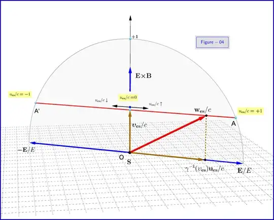

Although the magnitude of $\:\mathbf{E}''_{\bf es}\:$ is independent of the parameter $\:u_{\bf es}\:$ the electric field by its own is not. From equation \eqref{es-20a}
\begin{equation} \mathbf{E}''_{\bf es}\boldsymbol{=}\mathrm M\, \mathbf{E}\boldsymbol{+} \mathrm N \left(\mathbf E\boldsymbol{\times}\mathbf B \right) \tag{es-24}\label{es-24} \end{equation} where $\:\mathrm M,\mathrm N \:$ coefficients-functions of $\:u_{\bf es},E,B$ \begin{align} \mathrm M & \boldsymbol{=}\dfrac{\mathbf{E}''_{\bf es}\boldsymbol{\cdot}\mathbf{E}}{E^2} \tag{es-25a}\label{es-25a}\\ \mathrm N & \boldsymbol{=} \dfrac{\mathbf{E}''_{\bf es}\boldsymbol{\cdot} \left(\mathbf E\boldsymbol{\times}\mathbf B \right) }{E^2B^2} \tag{es-25b}\label{es-25b} \end{align} In terms of the $\gamma-$factors the result is \begin{equation} \boxed{\:\: \mathbf{E}''_{\bf es}\boldsymbol{=}\left[\dfrac{\gamma( u_{\bf es})\boldsymbol{+}\gamma(\upsilon_{\bf es})}{\gamma(\upsilon_{\bf es})\left[\gamma(u_{\bf es})\gamma(\upsilon_{\bf es})\boldsymbol{+}1\right]}\right]\mathbf{E}\boldsymbol{+}\left[\dfrac{\gamma(u_{\bf es})}{ \left[\gamma(u_{\bf es})\gamma(\upsilon_{\bf es})\boldsymbol{+}1\right]}\dfrac{u_{\bf es}}{E}\right] \left(\mathbf E\boldsymbol{\times}\mathbf B \right)\vphantom{\dfrac{\dfrac{a}{b}}{\dfrac{a}{b}}}\:\:} \tag{es-26}\label{es-26} \end{equation}

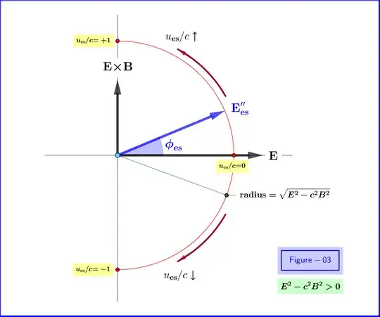

The tip of the vector $\:\mathbf{E}''_{\bf es}\:$ moves on a semicircle of radius $\:\sqrt{E^2\boldsymbol{-}c^2B^2}\boldsymbol{=}\gamma^{\boldsymbol{-}1}(\upsilon_{\bf es})E\:$ as the parameter $\:u_{\bf es}\:$ runs from $\:\boldsymbol{-}c\:$ to $\:\boldsymbol{+}c$, see Figure-03.
The expression \eqref{es-26} in terms of the unit vectors $\:\mathbf{E}/E\:$ and $\: \left(\mathbf E\boldsymbol{\times}\mathbf B \right)/(EB)\:$ is \begin{equation} \mathbf{E}''_{\bf es}\boldsymbol{=}\left[\dfrac{\gamma( u_{\bf es})\boldsymbol{+}\gamma(\upsilon_{\bf es})}{\gamma(\upsilon_{\bf es})\left[\gamma(u_{\bf es})\gamma(\upsilon_{\bf es})\boldsymbol{+}1\right]}E\right]\dfrac{\mathbf{E}}{E}\boldsymbol{+}\left[\dfrac{\gamma(u_{\bf es})}{\left[\gamma(u_{\bf es})\gamma(\upsilon_{\bf es})\boldsymbol{+}1\right]}\dfrac{u_{\bf es}}{c}cB\right] \dfrac{\left(\mathbf E\boldsymbol{\times}\mathbf B \right)}{EB} \tag{es-27}\label{es-27} \end{equation} so that for the angle $\:\phi_{\bf es}\:$ in Figure-03 \begin{equation} \tan\left(\phi_{\bf es}\right)\boldsymbol{=}\dfrac{\left[\dfrac{\gamma(u_{\bf es})}{\left[\gamma(u_{\bf es})\gamma(\upsilon_{\bf es})\boldsymbol{+}1\right]}\dfrac{u_{\bf es}}{c}cB\right]}{\left[\dfrac{\gamma( u_{\bf es})\boldsymbol{+}\gamma(\upsilon_{\bf es})}{\gamma(\upsilon_{\bf es})\left[\gamma(u_{\bf es})\gamma(\upsilon_{\bf es})\boldsymbol{+}1\right]}E\right]}\boldsymbol{=}\dfrac{\left[\gamma(u_{\bf es})\dfrac{u_{\bf es}}{c}\vphantom{\dfrac{cB}{E}}\right]\left[\gamma(\upsilon_{\bf es})\dfrac{cB}{E}\right]}{\gamma( u_{\bf es})\boldsymbol{+}\gamma(\upsilon_{\bf es})\vphantom{\dfrac{cB}{E}}} \tag{es-28}\label{es-28} \end{equation} Using the rapidities $\:\xi_{\bf es},\zeta_{\bf es}$ \begin{align} \tanh\xi_{\bf es} & \boldsymbol{=}\dfrac{\upsilon_{\bf es}}{c}\boldsymbol{=}\dfrac{cB}{E} \tag{es-29a}\label{es-29a}\\ \tanh\zeta_{\bf es} & \boldsymbol{=}\dfrac{u_{\bf es}}{c} \tag{es-29b}\label{es-29b} \end{align}
we have \begin{align} \gamma(\upsilon_{\bf es}) & \boldsymbol{=}\cosh\xi_{\bf es}\,, \qquad \gamma(\upsilon_{\bf es})\dfrac{cB}{E}\boldsymbol{=}\cosh\xi_{\bf es}\tanh\xi_{\bf es}\boldsymbol{=}\sinh\xi_{\bf es} \tag{es-30a}\label{es-30a}\\ \gamma(u_{\bf es}) & \boldsymbol{=}\cosh\zeta_{\bf es}\,, \qquad \gamma(u_{\bf es})\dfrac{u_{\bf es}}{c}\boldsymbol{=}\cosh\zeta_{\bf es}\tanh\zeta_{\bf es}\boldsymbol{=}\sinh\zeta_{\bf es} \tag{es-30b}\label{es-30b} \end{align} and so equation \eqref{es-28} gives \begin{equation} \tan\left(\phi_{\bf es}\right)\boldsymbol{=}\dfrac{\sinh\zeta_{\bf es}\sinh\xi_{\bf es}}{\cosh\zeta_{\bf es}\boldsymbol{+}\cosh\xi_{\bf es}} \tag{es-31}\label{es-318} \end{equation} But this expression is identical to the angle of the (Thomas-Wigner) rotation produced by the composition of two Lorentz boosts along two directions perpendicular to each other.(2)
In Figure-04 we see the continuous 1-parametric family of boosts that eliminate the magnetic field keeping an electrical field only.
