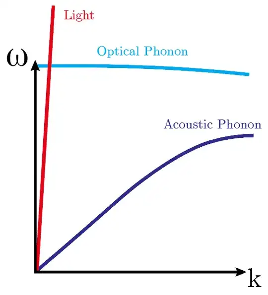

Why can the energy of a photon be directly absorbed by an optical phonon but not by an acoustic phonon?
BioPhysicist
  • 59,060
10
You need to consider both momentum and energy conservation. The speed of sound for most materials is so low that you can't conserve both quantities for a single photon to acoustic phonon absorption.
Think about the energy of a photon that is 100 meV (comparable to optical phonons). Then it has an momentum of roughly 0.5 um$^{-1}$. At this momentum, the highest acoustic phonon for any common material (e.g. diamond) is about 0.004 meV, so it cannot absorb the photon.
In pictures, look at the following figure showing the dispersion relations for light, optical phonons, and acoustic phonons $\omega=f(k)$. Which curve does the light line (red) intersect?
The light line can only intersect the optical phonon branch, never the acoustic one (except at zero energy, which is irrelevant). This is due to the velocity mismatch between the modes, which essentially means that the speed of sound is always much smaller than the speed of light.
However, using this same diagram, you can imagine multi-photon processes where you can excite acoustic phonons. There, you usually have a standing want of photons whose momentum difference matches the acoustic phonon. This is the principle behind Brillouin scattering, for example. These processes are generally much much weaker than direct transitions, but are still visible in certain circumstances.
