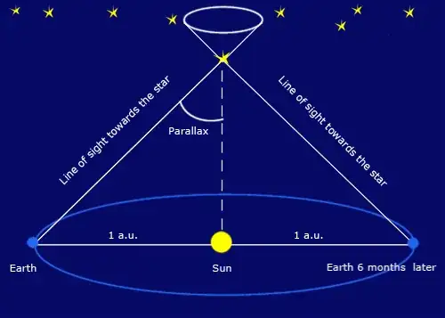

To measure distance of astronomical objects, often we may use parallax, the angle it makes with the earth-sun and trigonometry to determine the distance. enter image description here
The thing I don't get is why do we need to sweep out at least half a circle and then look at the angular difference. Why can't we just measure the angle at the maximum point of parallax? It seems better than having to half a year just measure the same angle twice. So why is it that we wait 6 months to take 2 readings?

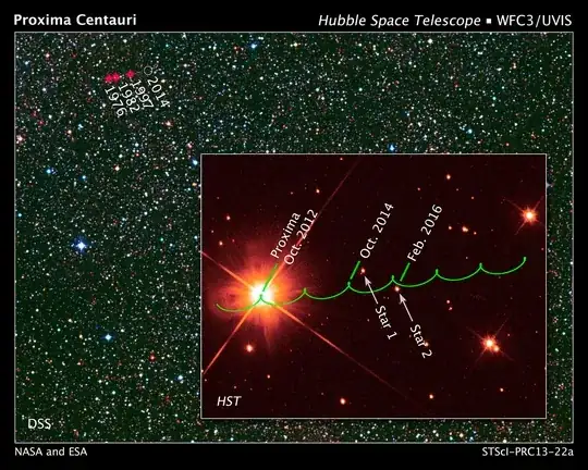

A picture says a thousand words. Here is the track on the sky of a nearest star (Proxima Centauri) which has a very large parallax motion (nearly an arcsecond), but also a large proper motion. The green line shows the path of the star as mapped out by a series of Hubble Space Telescope images. The upticks in the green curve, separated by 1 year, are the motion due to parallax, while the roughly horizontal drift is due to proper motion. So you have to imagine observing this curve for less than half the distance between the upticks and trying to accurately model these data with the sum of these two effects. It wouldn't be impossible for data of this quality and for a star where these motions are relatively large, but becomes increasingly untenable for more distant objects where the parallaxes and proper motions are smaller.
HST observations of Proxima Cen

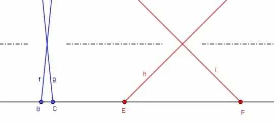

The larger the base ($BC$ vs. $EF$), the smaller angles of the rays from the base, the greater angle between rays (closer to the right angle), and - consequently - the more precise measuring.
Compare: Can you tell, where is the intersection of the blue rays?
Both pairs of rays have their intersection points in the same level (hight). But the red rays ($h$ and $i$) allow us to determine the point of intersection more accurate.
