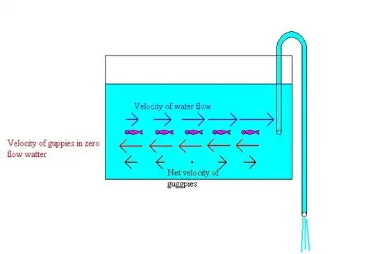

This is a water flow analogy with a black hole. Take a fish tank filled with guppies and put a large drain or siphon in the tank. This opening has to be big enough to set up a decent water flow. When the water starts flowing the fish will generally swim against the current. Assume all the guppies are the same size and generally swim at the same speed.
model configuration

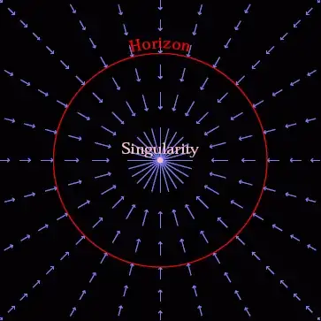

Then the rate they flow is a vector sum of the water flow and the swimming velocity in the absence of water flow. This will provide a visual model for how photons move in spacetime. The flow of water is a model for the flow of spacetime points. The guppies represent photons (modulo the fact they change direction at will), and the guppies within some approximate radius will tend to be taken up by siphon.
flow of spacetime point in a Schwarzschild geometry
