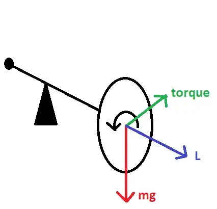

I'm taking the unusual step of posting an additional answer, just to explain why a particular widespread explanation falls short.
Here is how I understand this type of attempted explanation.
To establish a pattern:
Uniform circular motion due to a centripetal force:
With uniform circular motion the acceleration vector is perpendicular to the momentum vector. The momentum vector turns at a constant rate in the direction of the acceleration vector, and thus uniform circular motion is sustained.
The counterpart of that in angular mechanics is depicted in the diagram that was supplied by Aaron Stevens.
A torque vector (green arrow) represents a particular force pair. Here there is the downward force of gravity (red arrow) and there is the upwards force from the triangular block that supports the gyroscope. The combined effect is represented with the torque vector.
In the diagram the torque vector and the angular momentum vector are perpendicular to each other. The suggested precession law is then as follows: the angular momentum vector turns at a constant rate in the direction of the torque vector, and thus gyroscopic precession is sustained.

With the behavior recapitulated I return to the suggested precession law:
"The angular momentum vector turns at a constant rate in the direction of the torque vector, and thus gyroscopic precession is sustained."
Question: How should the suggested precession law be applied in case B and C?
Case B: the gyroscope wheel is spinning slowly, so the angular momentum vector is non-zero. Is the suggested precession law only valid above some particular spin rate, or is it valid for every spin rate, no matter how small.
If the suggested precession law is only valid above some particular spin rate, then what is the explanation of that?
There is another aspect:
Let's look at the following hypothetical case:
Let's assume that suggested precession law is as valid as Newton's laws of motion are.
That would imply that the start of gyroscopic precession is instantaneous. It would imply that truly the gyroscope wheel starts swiveling instead of doing any pitching.
That raises the question: where does the angular momentum of the precessing motion come from? The torque (green arrow) is perpendicular to the angular momentum vector of the precessing motion, so the angular momentum of the precessing motion cannot come directly from the torque (green arrow).
