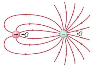

See this image with two unequal charges. The right negative charge ($-3Q$) has three times the size of the left positive charge ($+Q$):
(image from Chegg Study: physics questions and answers)
This is in accordance with Gauss's law for the electric field:
  • Draw a closed surface around the left charge ($+Q$) only.
    There are 6 field lines coming out of this surface
  • Draw a closed surface around the right charge ($-3Q$) only.
    There are 18 field lines going into this surface.
  • Draw a big closed surface around both charges together ($+Q-3Q = -2Q$).
    There are 12 field lines going into this big surface.
  • Draw a closed surface which does not enclose any of the charges.
    There are $n$ field lines going into and the same $n$ field lines coming out of this surface, thus giving a sum of zero.
In all cases the number of field lines (i.e. the electric flux) through the closed surface is proportional to the charge inside the surface.

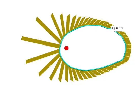

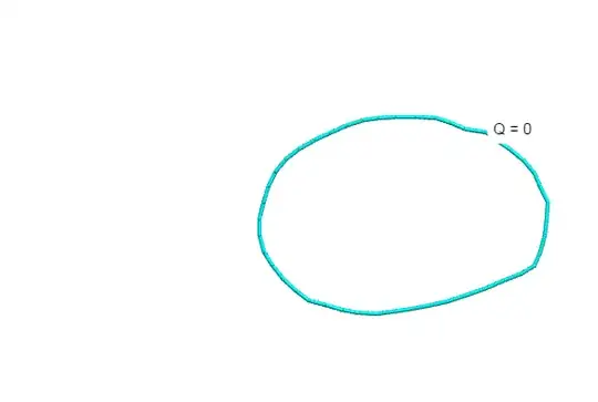

Using https://www.glowscript.org/#/user/matterandinteractions/folder/matterandinteractions/program/13-fields (and selecting Measurement type: "Gauss's law"), draw a closed surface then introduce a positive charge inside. Observe the outward flux through each patch.
Glowscript MatterAndInteractions 13-fields empty Glowscript MatterAndInteractions 13-fields centered

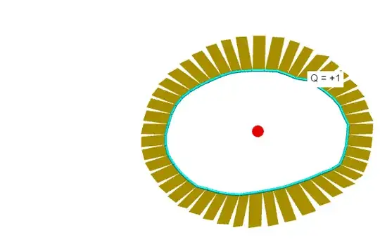

Now, as I reposition the charge [which is easier to do with this visualization], note that the flux through each patch changes... but the total remains constant [suggested by Gauss's Law, a physical law that says the total electric flux through a Gaussian surface is equal to the enclosed charge divided by $\epsilon_0$.]
Glowscript MatterAndInteractions 13-fields off-centered

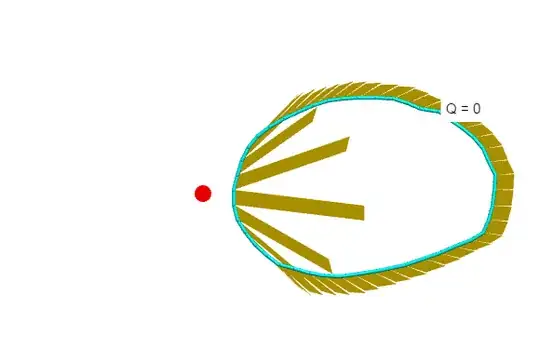

When I move the charge outside the Gaussian surface, the sign of the flux changes for the patches near the charge. The total flux drops to zero.
So, while external charges contribute to the local flux through a patch, their net [total] contribution to the flux is zero through a Gaussian surface that doesn't enclose those external charges.
