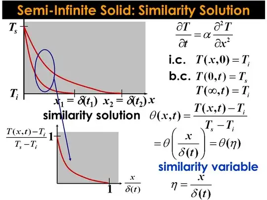

Let's take an example; below is a figure of transient heat transfer through a semi-infinite solid. If you look at the top figure it shows that at different times the cross-sectional temperature profiles are different; this makes sense because the solid is heating up. However if you properly scale the temperature and spatial coordinate and make them dimensionless: $$\theta = \frac{T-T_i}{T_s-T_i} \quad \eta = \frac{x}{\sqrt{4\pi t}}$$ then all profiles (for limited short time scale) collapse onto a single curve, the figure below.
I think this single curve in general is much more useful because it no longer depends on the values of the individual parameters (e.g. initial and wall temperatures) but on a dimensionless number which i can replicate if i ever have a similar situation but with different values for the initial and wall temperatures. I can then still apply this graph.
