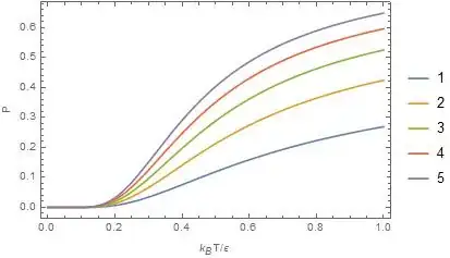

Consider if we have a simple two-level toy model, where the ground state has energy $E_0 = 0$ and the excited state has energy $E_1 = \epsilon$ and degeneracy $g$. The partition function for this system is $$Z = 1 + g e^{-\beta \epsilon}$$ where $\beta = 1/k_BT$. The probability of a particle being in any of the excited states at a temperature $T$ is given by $$P(\epsilon) = \frac{ge^{-\beta \epsilon}}{1 + ge^{-\beta \epsilon}}$$ which for various $g$ looks like
My question is, why does having a higher degeneracy of the excited state mean it is more likely to be populated at a given temperature? What physical principle tells us this should be so?

It's worth considering the high temperature limit, where $k_{\textrm{B}}T \gg \epsilon$ (or $\beta \epsilon \ll 1$). In this limit, all of the states have effectively the same energy, and since they have the same energy, they have the same probability of occurring. Thus, if $g$ is the degeneracy of the excited state, then the probability of being in any one of the states is $1/(g+1)$. This means that the probability of the system having energy 0 is exactly $1/(g+1)$, and the probability of the system having energy $\epsilon$ is $g/(g+1)$.
Thus, in making the transition from low temperature$-$where only the ground state is populated$-$to high temperature$-$where all states are populated equally$-$the probability for being in any one of the excited states must increase.
