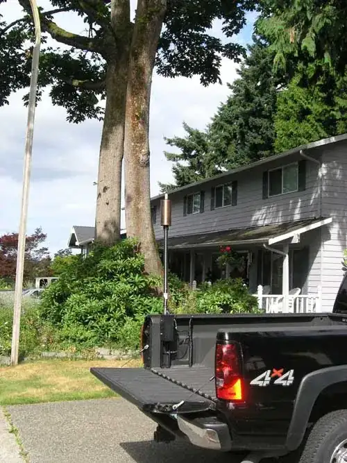

The mobile "screwdriver" antenna that I had on the back of my pickup truck for my mobile HF transceiver had a center-loaded coil (Inductance) to offset the usually capacitive antenna. Short antennas (shorter than resonant length for the frequency) are capacitive. Long antennas are inductive.
However, to make the antenna efficient for lower frequencies it is useful to make use of capacitance on the top of the antenna. This results in increased current along the upper radiating portion of the antenna (above the center loaded coil). Increasing the capacitance is done by adding conductors to the top of the antenna, usually radiating out up to 12 inches or so. This is called a "capacity hat" for the antenna. In the case of my mobile screwdriver antenna, adding the capacity had would give me 20 to 30 dB increased received signal strength.

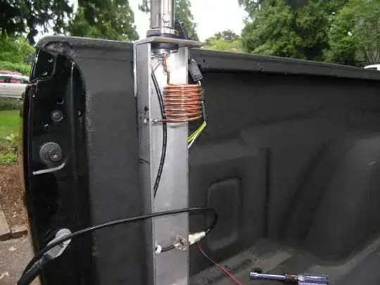

I thought adding a few photos would help in this description. This first photo shows the antenna and the inductor is there in the center. You can't easily see the top section (above the coil) as it is a whip antenna about 3 1/2 feet long. The coil is tunable with motorized screw drive controllable from the inside of the truck (yes, while I am driving).
To achieve a good match at the feed point at the base of the antenna for the lower frequencies (80 and 40 meter bands) I use a shunt coil. I create the coil merely by experimentation and not design to achieve a good match (low SWR on impedance match). It us usually about 2 microHenries or less at operating frequencies. For the lower bands (20, 17, 15, 12, and 10) it looks like an open circuit rather than a shunt.
