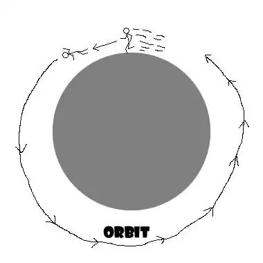

I just had this idea of orbiting a planet just by jumping and then flying upon it on its orbit kind of like superman. So,
Would it be theoretically possible or is there a chance of that small body to be & remain its unity?
Orbiting an asteroid by jumping

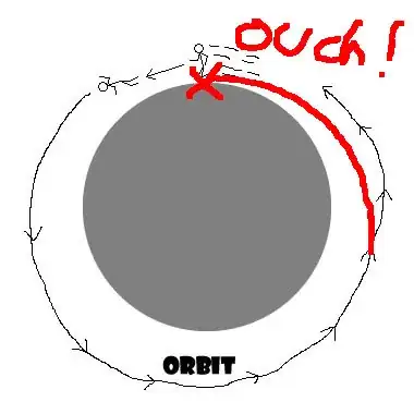

No, not by jumping. Jumping gives you an acceleration only from the location on the surface. As soon as you leave the surface, you have no way of adjusting your orbit. Either you reach escape velocity, or you will return to your initial location after exactly one orbit.
The only way to prevent this would be to have an additional acceleration once you have departed from the surface. Spacecraft use rockets to do this. A tiny acceleration may be enough — though I wouldn't like approaching a planet with high speed only to move 5 cm over its surface with high speed!
Edit: A different way would be jump from a ladder, as Claudius pointed out in the other answer.

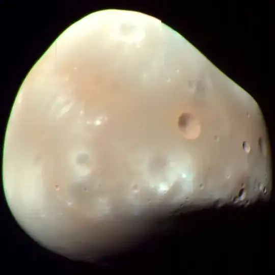

Deimos is between 10 and 15 km across and its escape velocity is about 20 km/h. At low altitudes, and since circular-orbit velocities are lower by $\sqrt{2}$ than escape velocities, you'd need to run up to some 15 km/h to orbit. Thus you'd do about one lap every three hours, whizzing along this ~city sized object at about bicycle speeds.
Picture of Deimos
On the other hand, it's unlikely that you will last very long in that orbit. The reason for this is that orbits are elliptical only around perfectly spherical planets, and any irregularities in the body you're orbiting will tend to perturb and even destabilize your orbit. Even on the Moon, low orbits are unstable and end up crashing into the surface, as was the fate of a subsatellite deployed during Apollo 16, which lasted only a month in orbit. With something as lumpy as the Martian moons, you would probably want to stay well away!
