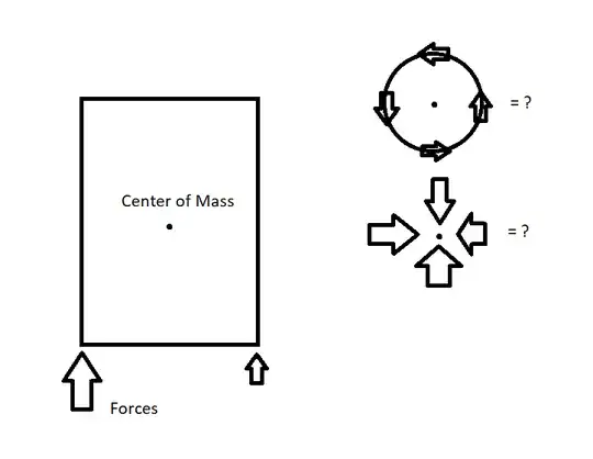

I'm having trouble extrapolating torque, rotation, and such into the information I want.
I'm trying to set up an estimation of a sea ship's movement for a game. The system is 2D. The ship has multiple arbitrary forces acting upon it to represent propulsion. I am assuming the ship is always stationary and facing forward. I want to get the rotational and translation accelerations for this simple ship and use them to change the velocities of a moving ship.
  1. Does this approach make sense?
If so the main question is: 2. How do I determine how fast it accelerating in x,y and θ?
And relatedly
  1. If there are opposite rotational forces, say +80 and -60 units, you would get +20 units rotation, but would the 60 that cancels out be converted back to translational force and added back into x and y?
Free body diagram sort of
Note: Ignoring other forces such as drag, which will be calculated separately. I understand all of the math just not the physics. The biggest problem I have is splitting up the forces and vectors in the correct way.

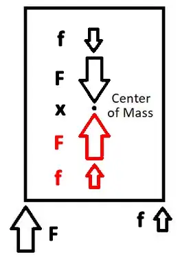

A way of analyzing such a situation is to "convert" the original forces $F$ and $f$ into couples (black arrows) and forces whose line of action go through the centre of mass (red arrows).
You now have an object of mass $m$ which is under the action of forces $F$ and $f$ (red) which will cause a linear acceleration $a$ of the centre of mass $F+f=m\,a$ and black forces which constitute two couples whose torque is independent of any axis and if $I_{\rm c}$ is the moment of inertia of the object about the centre of mass the angular acceleration of the object $\alpha$ can be found using $Fx=fx=I_{\rm c} \alpha$.
As the object undergoes translation and rotation you will have to decide whether or not the directions of the forces relative to the object change.
