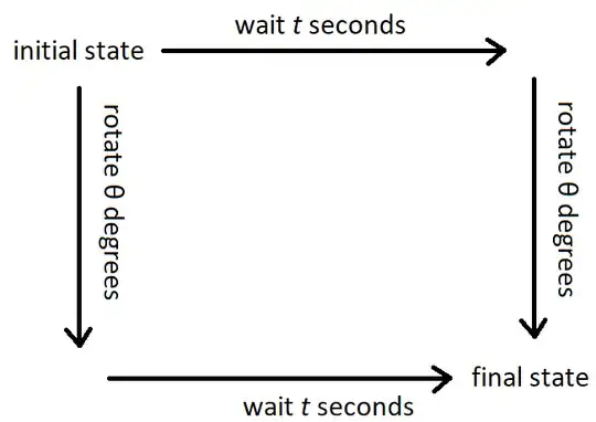

In my opinion, a "symmetry" in classical mechanics is an operation that commutes with time evolution. So, for example, if your system has a "rotational symmetry," then rotating your system, then time evolving it, will result in the same final state as time evolving it, then rotating it. symmetry commutation

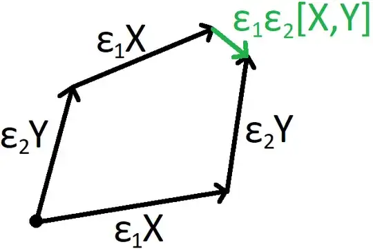

Note that the Lie bracket can be shown to give the "failure" of flows to commute infinitesimally.

Anyway, once you start thinking in terms of commuting flows, you realize that "symmetries" in classical mechanics are directly analogous to "symmetries" in quantum mechanics.
In quantum mechanics, we capture the above statement mathematically (suppressing $\hbar$) as $$ [e^{-i t \hat H}, e^{- i \theta \hat J}] = 0. $$ The above equation can actually be understood as four closely related equations.
  1. $[e^{-i t \hat H}, e^{- i \theta \hat J}] = 0$: Rotating and then time evolving a state is the same as time evolving and then rotating. (We have a symmetry.)
