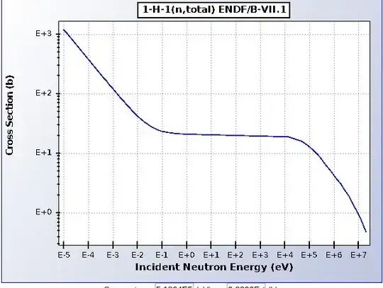

Per comments, you could look at energies of resonance peaks. The total cross-section for neutron scattering from protons (experimental data) looks like this:
total p(n,n) cross-section
( https://www.nndc.bnl.gov/sigma/getPlot.jsp?evalid=14960&mf=3&mt=1&nsub=10 )
I don't see anything that looks like a resonance peak in the relevant MeV energy range. (If you go to the URL, it lets you zoom in, but I still don't see any structure in the MeV range.)
