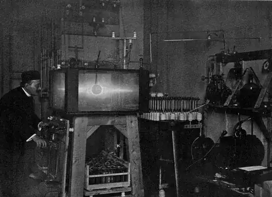

Look into something called a Terella, which is what Birkeland used to correlate "cathode ray" (high energy electrons) trajectories with similar ring shaped footprints in the Ionosphere.
David McKee
