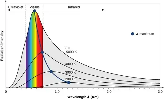

Matter comes in phases: solid, liquid, gas, plasma
Individual atoms/molecules join into lattices when solid, are in collective states in liquid, free in gas, and ionized mostly in plasma.
Transitions in the atomic energy levels you envisage are detectable only in gases and plasma, there the changes in n,l,m and the resulting absorption and emission of spectral photons can be detected, although there is also continuum photons from interactions in the spill over electric and magnetic fields.
In solids, there are a large number of energy levels that are lattice related, this means that there will be transitions in rotational and vibrational states that have nothing to do with atomic transitions. These transitions are the black body radiation, and are energy dependent. They also exist in the gas due to the kinetic energy . As you were told in comments this is the black body radiation, which characterizes temperature of a body. The higher the temperature the more photons in the visible.
bbody
Note the high temperature it is the high temperatures that gives us the observed light of the sun.
So yes, there are many energy levels , but it is the kinetic energy that dominates at high temperatures and gives a continuum of frequencies according to black body , or approximately ( atomic spectral lines can be filtered in a plasma, but it is the black body type of radiation that dominates).
Now for iron and metals in general the colors will barely touch the visible, as the temperatures are between 770K and 1480K
