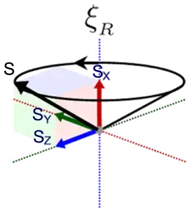

Each of the two spinors $\xi_L$ and $\xi_R$ represents a precessing vector $S$, the total spin. See the image:
The precession axis (typically $S_z$ but it can be anyone) can have any arbitrary orientation in space, it can point into any direction.
The operator $e^{-i\phi}$ acting on $\xi$ makes the total spin $S$ precess around $S_z$. This corresponds with the phase of the spinor.
The operators $e^{-i\sigma^2*\phi}$ and $e^{\sigma^2* \phi}$ precess the total spin around $S_x$ and $S_y$ respectively. (with the complex conjugate $*$ acting to the right and $e^{G\phi} = \cos\phi + G\sin\phi$, where $\phi$ is the half angle).

The equivalent Lorentz rotation operators acting on a spinor $\xi$ rotate the spin vectors $S_x$, $S_y$ and $S_z$ and their sum $S$, the total spin, around the $x$, $y$ and $z$ axis respectively. The spin of the bispinor field $\psi$ is given by the sum $S_R^z+S_L^z = S^z$ representing the axial current.
