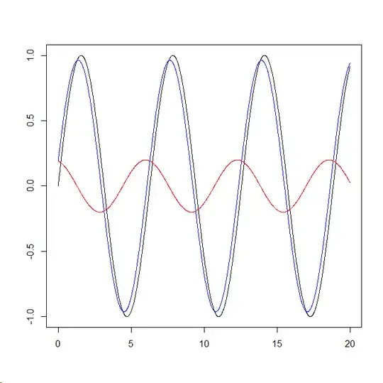

The key point is that the sum of two waves with different amplitude and phase but the same frequency gives you a wave of that frequency. This is shown in the picture where the black curve is $\sin(x)$, the red curve is $-.2 \sin(x+5)$ and the blue curve is the sum of the two. Same frequency, still a sine wave, but different phase.
addition of sine waves
Suppose there is an electric field $E=Ae^{i( \omega t-kx)}$. It falls on a molecule at (say) $x=0$. This is polarised by the field and oscillates and produces a field $Ere^{i \delta}$, where $r$ (which is small) depends on the polarisability of the molecule and the phase shift $\delta$ varies according to the difference between the applied $\omega$ and the natural resonant frequency of the molecule. So the combined field is
$Ae^{i \omega t }(1+re^{i \delta})$
The bracket can be written $(1 + r \cos\delta + i r \sin \delta)=Re^{i \phi}$
where $\tan \phi={r \sin \delta \over 1 + r \cos \delta}$ and $R^2=1+r^2+2 r \cos \delta$
So the effect of the polarisable molecule is just to shift the phase by a small $\phi$. (There is also a change in the amplitude but that's not at issue.)
If you have a series of such molecules then each has the same effect. The effect on the wave is multiplicative so the phases add. If there is a distance $a$ between molecules then in travelling a distance $x$ there are $x/a$ molecules giving a phase change due to polarisation of $\phi x/a$. The wave becomes $E=Ae^{i(\omega t - k x +\phi x/a)}=Ae^{i(\omega t -k' x)}$ with $k'=k-\phi/a$, i.e. the wavenumber (and thus the wavelength) change. The frequency is the same, so change in wavelength implies change in velocity.
This is the 'little bit of math' Orzel refers to.
