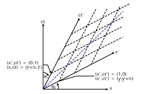

For me things started clicking when I looked more at Minkowski diagrams. Consider this picture for example (Source: https://www.sparknotes.com/physics/specialrelativity/kinematics/section3/page/2/). In this picture you have a stationary observer, call her Alice, and another observer, let's call him Bob, that is moving with velocity $v$ to the right indicated with prime coordinates. Now what events are simultaneous for these observers? For Alice everything that lies on a horizontal has the same time coordinate, so occurs at the same time. For Bob something similar holds: every pair of events that lies on a line that is parallel to Bob's x-axis is simultaneous to Bob. So this is meant when we say that two events happen at the same time.
You can draw this entire thought experiment on a Minkowski diagram. First draw A and B on the stationary x-axis at equal distances from the origin. You can draw the light signals if you want by drawing 45$^\circ$ lines. The time between two events (in some frame) can be calculated by drawing two lines parallel to that frame's x-axis and calculating the minimal distance between those two lines. For Alice these lightning events lie on the same line so the time between them is zero for her. For Bob these events don't lie on the same line anymore so they aren't simultaneous. The time it takes for light signals to reach M can be done similarly.
Edit I added the following (kinda cluttered) diagram because of Aaron's comment. Explanation: Thick black lines = Alice's axes, Thick Red lines = Bob's axes. Thin lines: lines of simultaneity, used to measure time. The time between the events is $\Delta t$ (for Alice) and $\Delta t'$ (for Bob) and the time between receiving the light signals is $\Delta t_{observe}$ for Alice and $\Delta t_{observe}' $ for bob. So are $\Delta t'$ and $\Delta t_{observe}'$ the same in this case? I don't know actually, maybe someone can work that out. enter image description here
