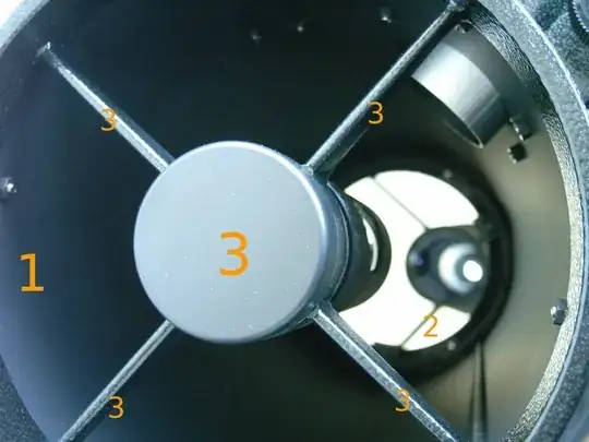

These are known as diffraction spikes. They are typically caused by diffraction on the struts that hold the secondary mirror in front of the primary:
Image source: Wikipedia
