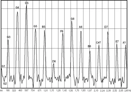

Let's examine the spectrum of frequencies from a violin string more closely. Here is a spectrum of the open G string (from here).
Spectrum of G string

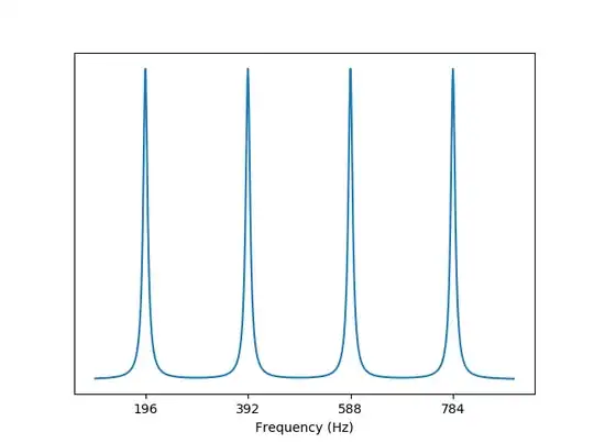

There is not simply one frequency peak, but rather a whole range of higher harmonics, at integer multiples of the fundamental G3. (For the reason why, see here.) I'll draw this as a cartoon now, concentrating on the fundamental and the first three harmonics.

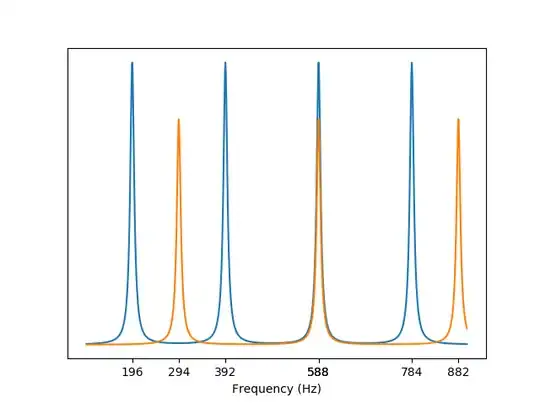

Suppose now our violinist starts playing the D string at the same time. The peaks from the D string are shown in orange below (and the musician is playing this string slightly more quietly, to help us distinguish the two.)
GD spectrum
The crucial thing to observe is that the second harmonic of the G string, and the first harmonic of the D string, are both precisely at a frequency of 588 Hz. But this is not the case if the violin is out of tune - if it is, a beat frequency is heard between these two harmonics. By carefully adjusting the tension of the G string, this frequency can be reduced to zero - and the violin is now in tune. (Or at least, those two strings are in tune relative to each other...) The effect can just about be heard on violin tuning how-to videos on Youtube, such as this one at 2:17.
