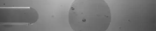

I'm trying to develop a very basic scaling law/unit analysis for viscous droplet formation, and I'd like to get some rough numerical values of the Reynolds number to play with. To be specific, I'm looking at the behavior of the smaller of the two droplets shown in the picture below (experimental setup shown sideways):
Experiment setup (sideways)
The darker fluid is a glycerol/water mixture and the lighter fluid is mineral oil - so it's a viscous fluid dropping into another (dissimilar) viscous fluid. I'm trying to understand how the viscosity of the dark fluid effects the size of the small droplet - the large droplet pretty much remains the same size, but the small one gets smaller for lower viscosities.

I'm not sure I fully understand your problem, as I only see the one droplet. However, I agree 100% with Jaime. You will undoubtedly form a Reynolds number from applying Buckingham's Pi Theorem, but that doesn't necessarily mean it dominates the physics of your problem.
I will add, however, that if you have an exact match of all your criteria of similarity, then the choice of length scale is irrelevant, since every length will have the same scale factor.
Your droplet looks pretty spherical, which implies constant surface tension (and low Re).
