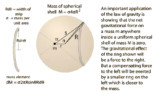

There exists the shell theorem, which proves that there is no gravitational potential within a mass shell:
gravshell
So it is only the mass of the sphere smaller than r that affects the acceleration: and the g in $U=mgh$ is effectively variable, becoming zero at the center.
