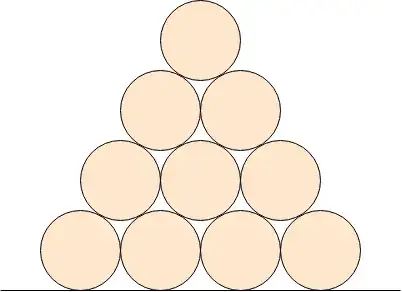

Suppose that you have a heap of logs. Each log is the same length $l$, the same mass $r$ , and the same radius $r$. For simplification, their rotational inertia is $I=\frac{1}{2}mr^2$, their coefficient of static friction with the ground is $\mu_g$, and with each other is $\mu_l$. Suppose we stack them in $n$ layers, with $n$ logs on the bottom, $n-1$ logs on the next layer, $n-2$ on the next, et cetera until the top row has $1$. I have made a diagram depicting a 4 layer log pile, shown below.
My overall goal is to find what values of $\mu_g$ and $\mu_l$ are required for stability. In order to do that, I would like to find the net downward force on the bottom logs. I am pretty sure we could model the entire system of logs with individual net force and torque equations, and solve for the relevant variables, but this way of finding the force is extremely unwieldy and time-consuming. However after a little bit of thinking, I began to hypothesize an easier way to do find it.
