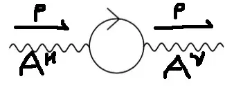

The way that this is usually done in QED is deeply related to the Ward Identities and QED's LSZ reduction formula. This discussion is taken from Chapter 67-8 in Srednicki's book "Ward Identities in QED I-II".
In particular it is related to the amputated correlators of $\langle 0 |T\{ A^\mu(x) A^\nu (0)\} |0\rangle$, which are the photon-photon scattering terms, which are related to the (momentum space) diagrams $\langle 0 |T\{ A^\mu(-p) A^\nu (p)\} |0\rangle_{amputated} $ of the form below (there could be higher loop contributions if you're masochistic enough, but this is the only diagram that contributes at 1 loop after amputation). We will consider amputated diagrams.
In particular, we'll have that
$\langle 0 |T\{ J^\mu(x) J^\nu (0)\} |0\rangle = \int \frac{d^4 p}{(2 \pi)^4} e^{i p x} [\langle 0 |T\{ A^\mu(-p) A^\nu (p)\} |0\rangle_{amputated} + \text{contact terms} ]$
where the contact terms are delta-function like terms that do not affect the divergence structure of the amplitudes.
where the contact terms are zero up to this loop order.
