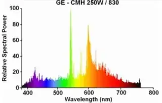

Every material has its own characteristic of the emitted photons over the full spectrum of wavelengths.
Metal halid lamp spectrum

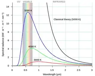

Specific for a block body is its characteristic emission spectrum which depends only from its temperature (and not from its material):
