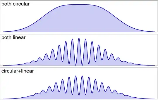

Adapting my code from this answer, this is what the interference patterns will look like, for (i) counter-rotating circular sources, (ii) both linearly polarized on the same axis, and (iii) one of each:
Mathematica source via Import["http://halirutan.github.io/Mathematica-SE-Tools/decode.m"]["https://i.sstatic.net/9ewmD.png"]
As you can see, there's a fair amount of interference left. But it's also important to note that the amplitude of the fringes does is smaller, and that the bottom of the troughs at the center no longer reaches down to the axis, i.e., there is no longer any complete destructive interference anywhere on the pattern.
