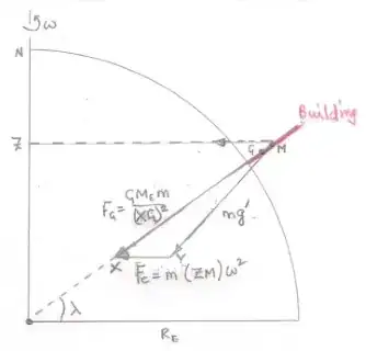

To answer your question fully is very difficult so I will make some assumptions to start with.
Assume that the Earth is a rotating sphere with angular speed about the $NS$ axis $\omega$, that its mass ii $M_{\rm E}$ and it has a radius $R_{\rm E}$.
Let the tall building be of uniform composition and that its centre of mass is at position $M$ as shown in the diagram below.
The centre of gravity of the tall building is at position $G$ and the building has a mass $m$.
The answers here and the links within explain the reason for the centre of mass and the centre of gravity not being at the same position in a non-uniform gravitational field.
The gravitation force on the tall building is $F_{\rm G} = \dfrac{GM_{\rm E}m}{(XG)^2}$ and the line of action of this force acts through the centre of mass of the tall building.
That gravitational force can be resolved into two components $F_{\rm C}$ which provides the centripetal acceleration of the tall building $ \omega (ZM)^2$ and $mg'$ where the line of action of $g'$ does not go through the centre of the Earth.
I have purposely not introduced pseudo forces and totally ignored the stability of the building ie omitted the force (and torques) on the building due to it being in contact with the Earth.
The analysis becomes much easier if the building is very close to the Earth so that the magnitude of the gravitation field of the Earth in the region of the tall building is constant.
You could then say that the position of its centre of gravity $G$ is, to a very good approximation, the same as its position of the centre of mass.
