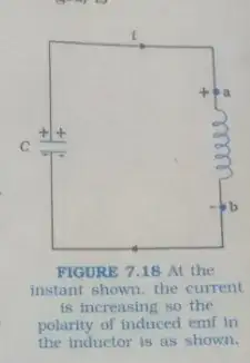

Let a capacitor be charged $q_m$ (at $t=0$) and connected [to] an inductor as shown in Fig. 7.18.
The moment the circuit is completed, the charge on the capacitor starts decreasing, giving rise to current in the circuit. Let $q$ and $i$ be the charge and current in the circuit at time $t$. Since $\mathrm{d} i/\mathrm{d}t$ is positive, the induced emf in $L$ will have polarity as shown, i.e. $v_b<v_a$. According to Kirchhoff's loop rule, $$ \frac{q}{C} - L \frac{\mathrm{d}i}{\mathrm{d}t} = 0 \tag{7.39} $$ $i = -(\mathrm{d}q/\mathrm{d}t)$ in the present case (as $q$ decreases, $i$ increases). Therefore, Eq. (7.39) becomes: $$ \frac{\mathrm{d}^2 q}{\mathrm{d}t^2}- \frac{1}{LC}q = 0 \tag{7.40} $$ This equation has the form $\frac{\mathrm{d}^2 x}{\mathrm{d}t^2}- \omega_0^2 x = 0$ for a simple harmonic oscillator. The charge, therefore, oscillates with a natural frequency $$ \omega_0 = \frac{1}{\sqrt{LC}} \tag{7.41} $$ and varies sinusoidally with time as $$ q = q_m \cos(\omega_0 t + \phi) \tag{7.42} $$ where $q_m$ is the maximum value of $q$ and $\phi$ is a phase constant. Since $q=q_m$ at $t=0$, whe have $\cos(\phi)=1$ or $\phi=0$.

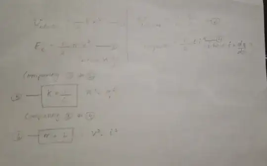

This is the comparison between mechanic system ( spring - mass system) and LC - oscillator. enter image description hereenter image description here
