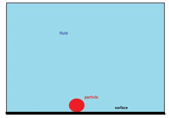

We have a particle that is diffusing actively (meaning that the source of energy is a motor; the diffusion is like a Brownian motion, the only difference is that the diffusion coefficient is much higher) on a 2D flat surface in a fluid. The diffusion coefficient is $D$ so that $\langle x^2\rangle=4Dt$.
The reason the particle is not diffusing in the volume is because the particle is too heavy: $\rho_{particle}>\rho_{fluid}$.
My question is about the relation between the relation between the friction coefficient, the diffusion coefficient and the size of the particle. Since the friction coefficient is proportional to the gravity, $F_{friction}=\mu_s F$, the bigger the particle, the more friction there will be, and the lesser will be the diffusion coefficient.
Is there a way to formalize that with a relation $D(D(r_0),\mu_s,r,\rho)$ with $D(r_0)$ the diffusion coefficient for a particle of size $r_0$, $\mu_s$ the coefficient connecting gravity and $\rho$ the density of the object.
