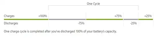

I'm aware of how battery cycles work: https://assets.pcmag.com/media/images/567210-apple-chart-iphone-charge-cycles.png I'm also aware that battery life/health decreases over time and it's just a process that can't be helped because entropy.

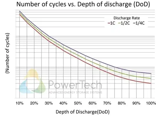

I have included a figure for the Cycle number as a function of Depth of discharge. enter image description here
As you can see the cycle number decreases dramatically the larger the range of state of charge usage is. The cycle number for a given cell chemistry is a function of the temperature, C rate (current) and the State of charge (Depth of discharge)
