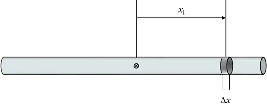

Say we have a symmetrical and homogenous rod with mass $M$ and length $L$ and a rotating axis in the middle of the rod, dividing it into two halves. Its moment of inert is $$I_{cm}=\frac{M{L^2}}{12}$$ Now we cut rod in half, the halves in halves, etc and continue that infinite times, while keeping them in the shape of the original rod. The question is what is the moment of inertia of all the rods combined. My answer is $$I=\frac{2M{L^2}}{3}$$ and I want to check if I am right. By doing the process about for a few cuts, I concluded that for n cuts, the small rods will have $$I_n=\frac {M{L^2}}{12}\frac 1{4^{n-1}}$$ with the axis as described above. Then I used the Parallel axis theorem for the first few cases for one side of the half original rod. When increasing the rods I used it for the two rods that were formed by a cut, then using it again in the same way to find the new axis of the four rods that were formed by a cut and so on. Then I arrive at the expression :$$I_{n_2}=\frac {M{L^2}}{12}\frac 1{4^{n-1}} + \frac {M{L^2}}{12}(\sum_{n=1}^n \frac1{4^n})$$ The geometric series converges $\space$ $\sum_{n=1}^\infty \frac1{4^n}=\frac13$ $\space$ and $\space$ $\lim_{n\to \infty}{\frac 1{4^{n-1}}}\to0$ $\space$ so $\space$ $I_{n_{\infty}}=\frac{M{L^2}}{3}$. So, in the end, we have $$I=\frac{2M{L^2}}{3}$$ (I am really sorry if my explanation is complicated and hard to follow. Ask me if you have a question pertaining to the explanation. If you understood, can you check the answer?)
