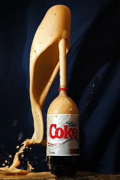

It takes a while for your drink to become flat because it starts with quite a lot of CO2. To get an idea of how much CO2 is in your bottle, look for the youtube videos showing what happens when you drop certain candies into it:
CO2 erruption from wikipedia
http://en.wikipedia.org/wiki/Soda_and_candy_eruption
That's a lot of CO2, but eventually, if you open up that bottle enough, most of it will get out.
