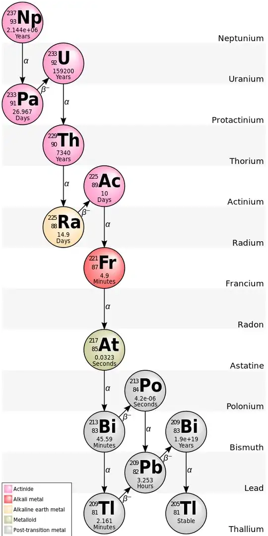

Examples of depletion without natural replacement are the four decay chains, Thorium series, Uranium series, Actinium series and the Neptunium series with only the last two isotopes of the Neptunium series occurring naturally because the parent and its other offspring have a comparatively short half life.
