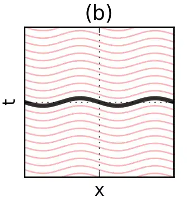

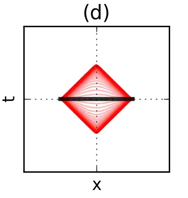

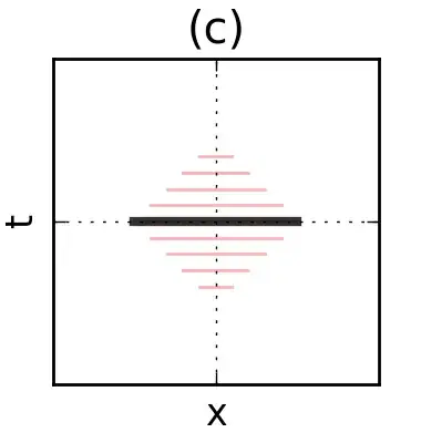

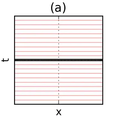

Consider the following four slicings:
Why is the difference between these so important? Consider each one:
(a) If you slice like this, the spatial metric is always flat, and the integration is easy. You can only do this because you already knew the answer.
(b) If you slice like this, the spatial metric could be something horrible, and the integration could be difficult, even though the spacetime is trivial. You might do this by accident if you start from scratch.

(c) Slicing like this could work, and would make the integration easy, but leaves an ambiguity in the boundary conditions. You could do it, but you have to make sure the numerical solution includes the domain of dependence of the initial surface, and discard parts of the solution outside.
(d) This slicing has obvious boundary conditions and a clear physical interpretation in terms of the domain of dependence, but the spatial metric and differential equations are much worse.
