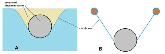

"Since no part of the needle is under the water, buoyant force can be ruled out."
The needle is below the water level, so actually there is displaced water and a buoyant force. If the membrane where the surface tension is located is in equilibrium, it needs to receive an upward force. In figure A that upward force is the buoyant force due to the displaced water. (In B, a membrane suspended between two edges, the upward force is provided by the edges.)

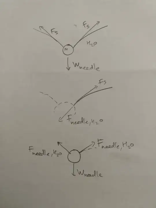

As described in this question, the water surface isn't flat at the point of contact. The surface tension is tangential to the water surface, and can thus have a vertical component if the surface is curved.
The free-body diagram below should explain the balance of forces between the needle and the water surface.
Hastily drwan free-body diagram
