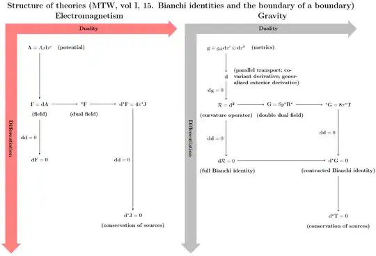

  1. The counterpart to $(\text{metric }g,\text{curvature }R)$ in GR is $(\text{gauge potential }A,\text{field strength }F)$ in E&M.
  2. If you write $F=F(A)$ in E&M, then the Bianchi relation (2) is not needed/a tautology, cf. e.g. this Phys.SE post.
  3. For how GEM appears as a limit of GR, see e.g. this Phys.SE post.
